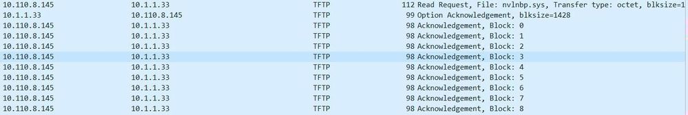

See here an example:
Classic mirror:
ERSPAN:
big data packets are silently dropped - only ACK are seen

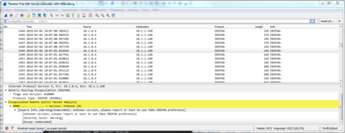

i see that Wireshark natively support to decode GRE tunnel.
So i miror the captured packets directly to my pc.
BUT see the following results:
Wireshark recognize this as (Ciscos) ERSPAN and cannot decapsulate it.
Is there a chance that wireshark can handle this GRE packets ?
If yes this would be much more easier than configuring a GRE Tunnel on XMC or Analytics, just to have the chance to look into mirror packets.
