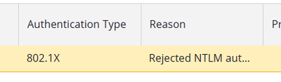

My question is, can local administrator accounts on end user devices somehow be authenticated to give network access?  When I login with the local administrator account, the network drops off after a short time.  In XMC I can see for the local administrator account the message "Rejected NTLM Authentication".

Hello Ryan - I have tried as suggested and have a couple of issues.
1. The setup as it is, the Rule created for this is not hit and the Authentication attempted is 802.1X see below.
2. When I run the Evaluation Tool for this, it comes back as OK and no issues - see below.

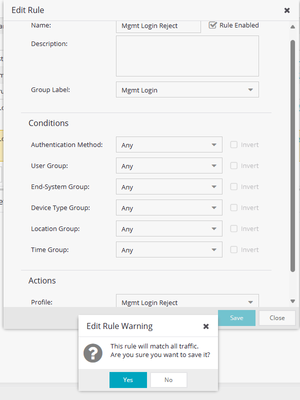

AAA Rule
Access Rule

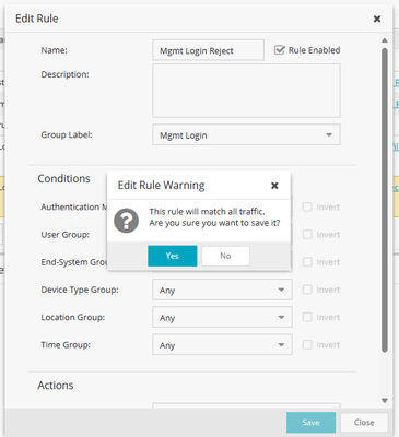

I also have an issue where the Reject Rule is applied across the board and is leading to Authentication rejections.  I have turned the Reject Rule off for now - see below.
The Reject Rule is directly below the Accept Rule.  Something I believe is wrong with the setup/placement of this Rule.
