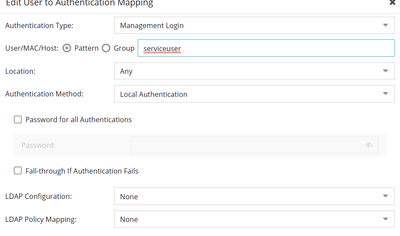

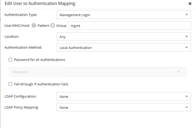

@Ryan_Yacobucci I have created the local user as per instructions please see below.

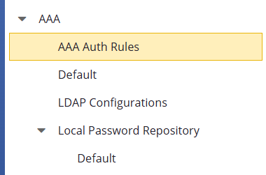

I have created a new AAA Rule for this and placed this at the top of the list - please see below.

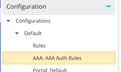

I have created a new Rule for this as described - see below.
Profile is below.
Then the Reject Rule - this is what I am unsure about.  I have set this to Reject Authentication Requests - see below.
In total, it looks like this - see below.
I believe this is all that is needed from the AAA and Rule side.  Please correct me if I am wrong.

Hello,
This looks pretty good to me.
Authentication is configured to handle the local users by the local password repository.
Authorization is configured to send back an administrative response if it's an authorized user, and ANY other management logins will be rejected.
