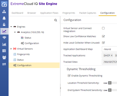

In the analitycss dashboard there is no info about networks and application response.

Can you check to see if the analytics sensor is up and running:
SSH to analytics and run:
appidctl status
Can you confirm Analytics is receiving both sflow and mirror traffic with a tcpdump:
https://extremeportal.force.com/ExtrArticleDetail?an=000082115
If you re-run appidconfig can you confirm the interfaces are in the correct mode?
