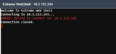

open device terminal in XMS (web version Netsight) cann't connect to switch with SSH
JohanHendrikx
Contributor II
How can I change the port number op the open device terminal ?
Now I got an error: Failed to connect

Bastian_Sprotte
Johan,
the open device terminal defined in the CLI Credentials.
You need to go via Administration>Profiles>
there you see the SNMP Profiles and on the right side the CLI Credentials you use. On the CLI Credentials TAB you can create SSH/Telnet profiles, this now combine with the SNMP profile allow you the right click action.
regards
Bastian
Bastian,
I have created the CLI credentials. When I use the JAVA console, SSH works fine
Johan Hendrik System Architect Audax
Ronald_Dvorak
Honored Contributor
I don't think that is possible in the GUI, the default for telnet(23) & ssh(22) is used.
