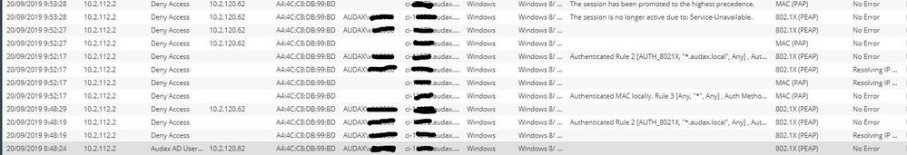

I’am configuring NAC on our switches and have created 802.1x rules for our AD PC’s and users.
We are testing this with 3 pc’s. The management access to the switch is based on AD (LDAP).
The ports of the switch are configured for 802.1.x and MAC authentication.
Now we experience that two pc’s lost the connection with the network. At that time I could not log in to the switch. 100% sure that I used the correct credintials.
In the end system events I noticed that the profile was changed form AD-user profile to the denny access profile.
After a while I can log in the switch an the pc got the access to the network back.
How can I troubleshoot this.

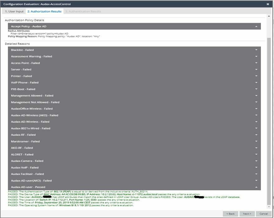

Ryan_Yacobucci
Well that does look a little funny.
The rule looks pretty straight forward, only an LDAP criteria.
Right click the NAC --> WebView --> diagnostics --> communication Diagnostics and test the LDAP. Are there LDAP issues occurring like timeouts?
The other thing you can do is in the webview --> diagnostics --> End System Diagnostics enable by MAC for your test device and have it fall through the rule. Attach the end system events and the /var/log/tag.log to a case with GTAC and we can take a look to see why it's falling though.
I would suspect LDAP communication issues based on what you've provided.

forgot to add the Screenshot of the evaluation tool and device event.
