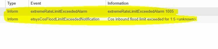

The XMC receives two different informs: extremeRateLimitExceededAlarm and etsysCosFloodLimitExceededNotification.

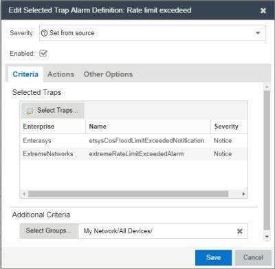

This is the alarm configuration:
With the action set to email.
The problem is that XMC gets the traps but it doesn't generate the alarm and of course doesn't send the email. The alarm doesn't show in alarm history.
Other alarms of type "selected trap" are working fine and the emails go out no problem.
