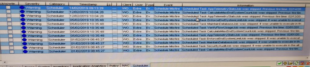

In my netsight 8.1.6.20 the Log tab SCHEDULER does not update
In fact it is stopped in 14 feb 2019 despite having verified events to be detected such as the backup of the scheduled system every week.
does anyone know how to resolve this problem ?

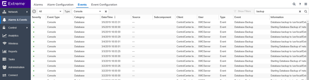

With system you mean the XMC database backup - if that is the case you'd find it in the Java UI in the Console tab or the Web GUI as per the below example...

The Scheduler tab will show logs from the task section in the web GUI > you'd need to create/run a scheduled task to get a log entry.
e.g. I've a script/task that clears the NAT table of my FW every night because I have some issues with my site2site VPN (= the script will ssh to my FW and clears the table).

In my netsight the backup of switch/device configuration is showed in the inventory tab while the backup of system is showed in scheduler tab
