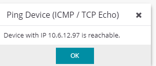

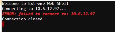

Ping issue has been resolved able to figure out that firewall was blocking the outflow traffic from the switch. Although devices are reachable, bidirectional traffic flow is available still from the webshell it shows connection closed. I believe that would be the starting point to proceed ahead with the further archieve/firmware etc..
Below snapshot does trigger anything much???
