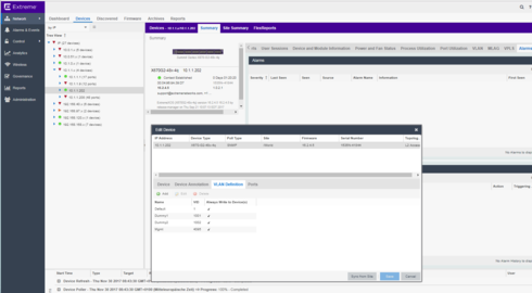

Sometimes Netsight 8.0.x does not allow VLAN Definition on new switches.
See here - EXOS Switch with V16.2.4.5:
If i start MIB Browser i can read VLAN Information.
At next day it works ...
It seems that there needs to be a overnight run to recognize the ability for 802.1Q MIB VLAN Management ...
Does anybody know how to trigger this process (that i do not have to wait overnight) ?
Or is there another reason why netsight does not offer VLAN Definition on this switch ?
Thanks for feedback.

AFAIK the "edit device" window will provision the switch from the site configuration. It may not fetch the VLAN info from switch.
Can you check the "device view" for the VLAN information and see if the info is present there?
right click device > view > Device details > Device view
For a last test i upgrade the switch to EXOS 22.3.1.4 PAtch 1-4 (because i use a G2 Switch) and surprise, surprise after re-descovery VLAN Definition is possible !
EXOS 16.2.4.5 Bug or Netsight 8.0.4 Bug ???
