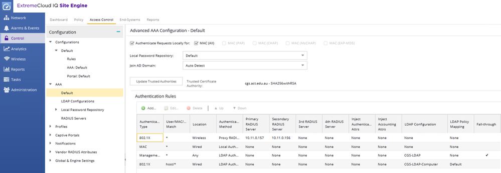

I'm building up my XIQ-SE deployment prior to receiving an order, I've been having a few issues and I hope someone experienced may be able to spot the cause on this one.
I previously had these AAA settings being loaded to the switch when I pushed the ZTP configuration but now the "show configuration detail" shows radius as disabled and none of the settings have been loaded (everything else has been pushed correctly).
I was troubleshooting AP aware and changed some settings while considering having NAC do the LDAP requests (instead of being a proxy to NPS), I'm expecting I changed a setting while looking at these options but I can't find what's different. As a side note I have had this happen previously and it returned to normal after i rebooted the Extreme servers but no luck this time.
Any guesses to what I need to check or good references to look over? I have been using the online guide but it's hard to find examples of how the settings are utilized together.
Pointers are appreciated.
