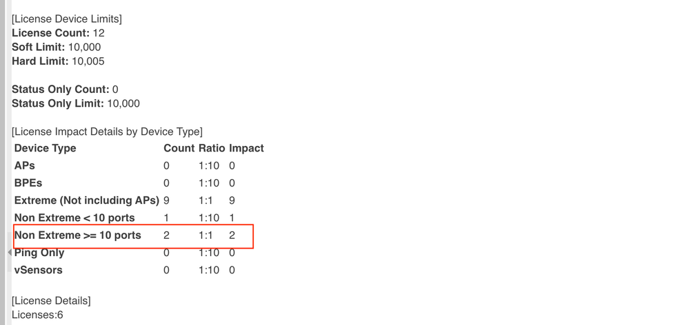

I've tested in my LAB (XMC 8.5.with 2 AP510C (former Aerohive AP650) and it shows as Non-Extreme >= 10 ports, consuming 1:1 licenses…
Ex: 2 AP650 Added:
2 AP650 Added
Now, after I deleted 1 AP650:
After deletion of 1 AP650
We are worried, because IF this is true for AP310 and AP410, and IF the customer needs to upgrade the XMC license to support the new APs (if it was 1:10, the customer have plenity of free licenses on XMC, but if it's 1:1, not) the project will be cancelled and we are excluded from the RFP.

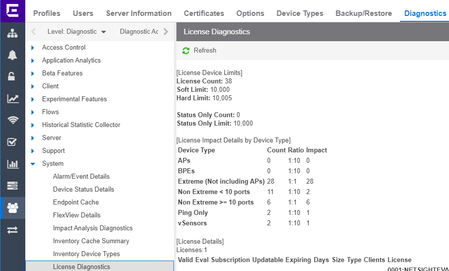

Zdeněk_Pala
it may depend on the type of APs. the answer from Ryan is valid for Identifi APs.
If you add other APs, then each AP does count 1:10 license = 9 APs count as one node license, 11 APs count as 2 nodes.
In my case I have 11 devices with less than 10 ports = counted as 2 nodes
