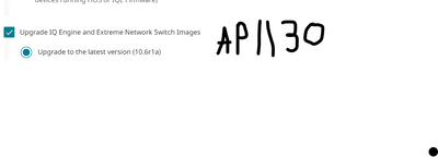

And guess what, I just happened to be looking at an AP1130 to troubleshoot it, and BAM... there is a firmware update for them!
WHAT!? Yeah, 10.6r1a
Never got an email, no notification on the dashboard, nothing...... After all the battling back and forth, no one the knowing what was going on with the support of that model, being told yeah its supported to finally no its not supported, then that document mysteriously changing from supported to not supported (with an End Of Life statement making its way into the same document), and by sheer luck i stumble on the fact there is a firmware update... This is not great.
Here is a screenshot of the firmware notice:
Maybe this will fix a lot of the bugs and issues ive seen with that model... also, has an "a" at the end, so there may be more updates...... we will see.
Did anyone else get any kind of notification about the new firmware update for those AP's, im just curious if they just missed me, or forgot to tell their customers.
