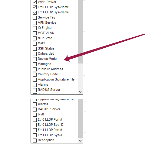

I meant Device Mode by Mode. See the screenshot below. Apologies.

Paul_Wang
Hi John,
If I am not wrong, other than listing the device mode on the Manage Devices page, getting the notification for the backhaul failover is not natively supported by XIQ or HiveOS/IQE.
Maybe you can look into using XAPI. Device Mode should be included in an XAPI call like below.
https:///xapi/v1/monitor/devices?ownerId=xxx
See below for the details.
https://developer.aerohive.com/docs/api-documentation
The other possibility is to setup the syslog and process the log for the backhaul failover according to your needs.
I haven't really looked into the SNMP trap for this, but I think it's not supported either.

Paul_Wang
Hi John,

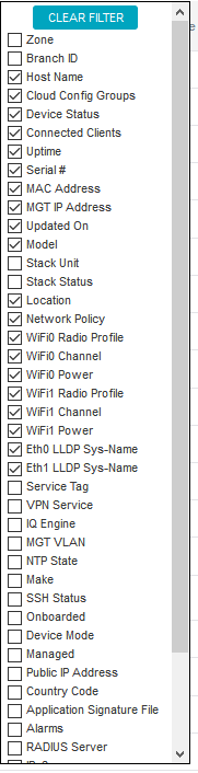

w1f1n00b
Contributor II
I don’t appear to have that column option.
