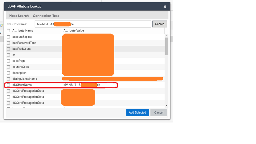

As shown in an earlier Screenshot, the Eval tool claims, that the Host “MV-xxx.de” does not have LDAP-attributes defined in the LDAP Host Group “End System Groups AD machines”.
Verifying this with LDAP-Test : see below:
So, there IS such an entry.
What I am confused about: This entry is found as “dNSHostName”.

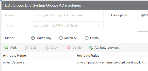

According to ealier mentioned guide, “objectcategory” is defined as attribute for the group.
 However, changing this to dnsNostName does not work either.
I checke configuration vs. guide several times…..don´t find the mistake.

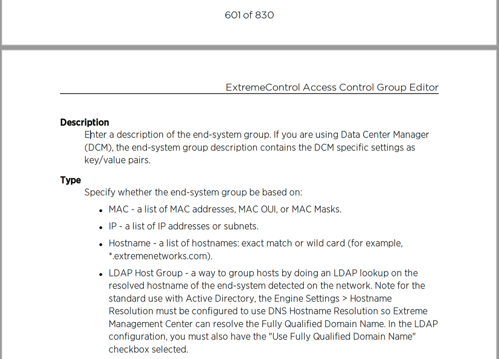

Are you meeting all the requirements for the LDAP groups?
See documentation:
