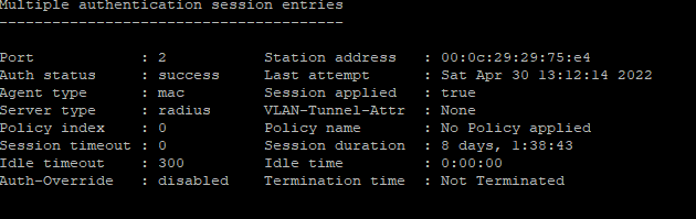

Hello,
If you do:
show netlogin session port 1
Do you see any netlogin sessions active on the port?
If disable/enable the port do you see anything in the "show log" that indicates if RADIUS authentication was successful?
05/08/2022 13:28:24.88 <Info:nl.ClientAuthenticated> Network Login MAC user 000C29B85639 logged in MAC 00:0C:29:B8:56:39 port 2 VLAN(s) "Default" policy "None", authentication Radius
If Control doesn't process the request it will not show up in the end systems tab. You can check the /var/log/radius/radius.log to see if the RADIUS request was dropped because it is not authorized.
You can check the /opt/nac/radius/raddb/clients.conf file to see which switches are authorized.
Switches must exist in the "Switches" tab to be considered authorized and Control will drop any RADIUS request from unauthorized switches.
Thanks
-Ryan

Hello all,
here is an update and the solution to the problem.
I got the following error message in the logs:
Mac authentication was initiated, but mac-list for virtual router for VR is empty
I fixed it with the following instructions:
https://extremeportal.force.com/ExtrArticleDetail?an=000061757
@Ryan: Thanks again for the hint.
