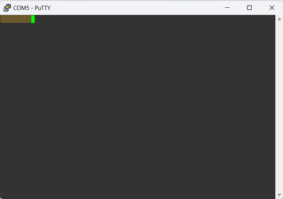

We've purchased an Extreme Networks 5420F-24P switch and are trying to connect to the interface via putty or MobaXterm with the configuration indicated in the Guide:
Baud rate: 9600
Data Bits: 8
Stop bit: 1
Parity: none
Flow control: none
But it dont work.
Can anyone help us?
Sincerely.

Carsten is correct, the speed for these universal switches is 115200.

‎02-23-2024 05:21 AM
Hi, maybe it is the baudrate. Please try 115200.

‎02-23-2024 07:48 AM
thanks it works
‎02-23-2024 07:06 AM
Thanks, but I've already tried that too but it still doesn't work.
