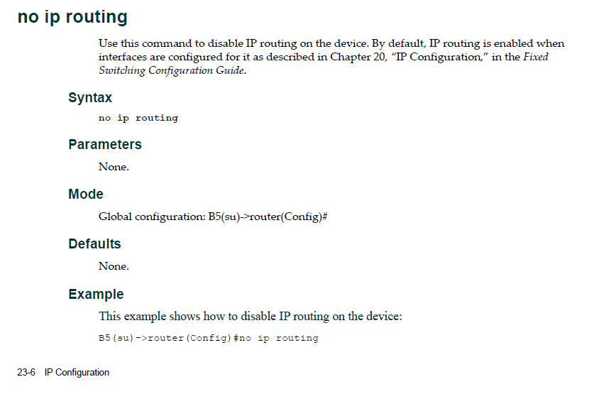

So will you tell me that to segregate the vlan is not enough to set the switch routing configuration as above?????
I must to set also the "no ip routing" ??????
Would this explain the ping between the various PCs of various VLANs?
Ronald_Dvorak
Honored Contributor
as per CLI reference guide routing is enabled by default
-Ron
