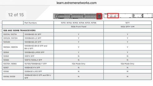

Alexandr_P
Valued Contributor
I think, first question have to be - is 10gig VIM module support 1gig speed?
Because in Data_Sheet and HW_Install_guide there is no information that this VIM can work in 1gig.
Thank you!
a9f60ec9ca6e4e8bae8dc91581669673_RackMultipart20160121-29532-1uei1hb-IMG_3397_inline.png
