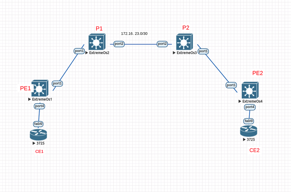

I have test VPLS service as below design
CE1------>>PE1------>>P1-------->>P2-------->>PE2--------->>CE2
PE1 and PE2 are spoke router
P1 and P2 are core router
I have configured vpls spoke to core between PE1 and P1 , PE2 and P2
P1 and P2 has vpls core full mesh
P1 and P2 vpls profile have confiugred dot1q exclude and PE2 and PE1 configured dot1q include
I got ping access between CE1 and CE2

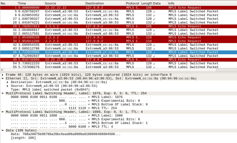

And I have captured packet in wireshark ,only see MPLS VC label and transit label
Can’t see dot1q tag detial in packet and it have data
I need to data packet details .

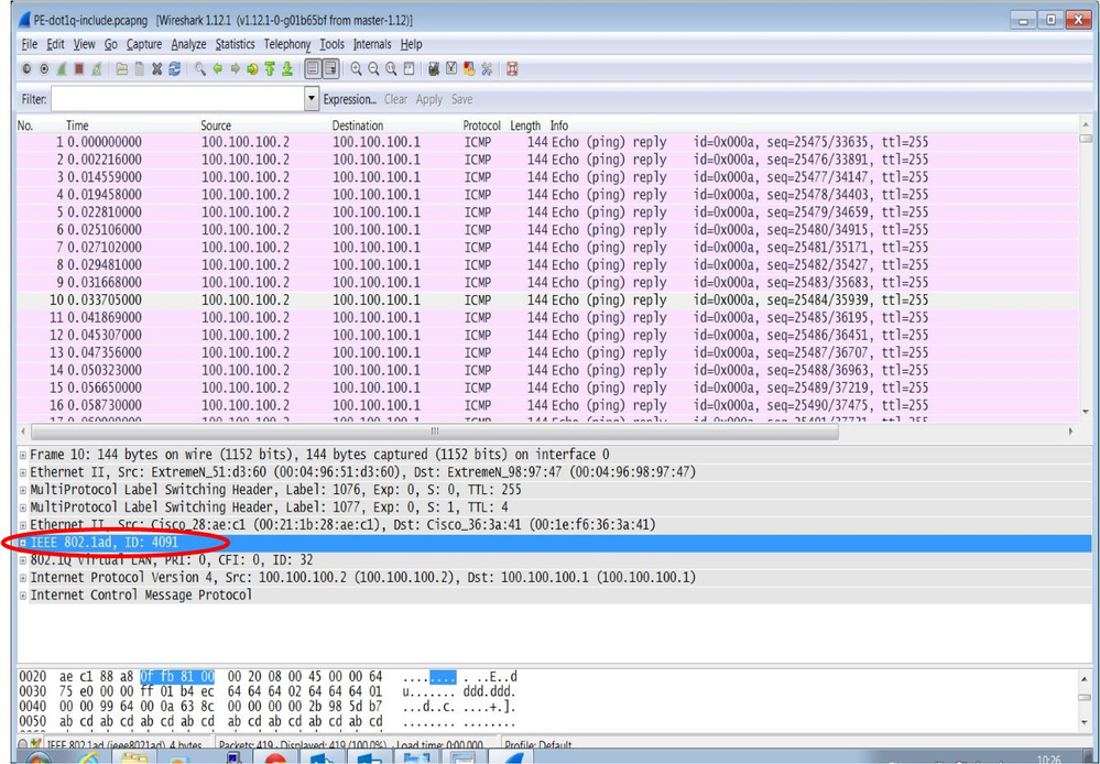

Please see wireshark packets details
I need to know data packet and what have it under as like below image that is you says

In my testing, I haven’t configure VPLS PE1 to PE2 directly.
I have configure three vpls segment.
PE1 to P1 configure VPLS Spoke to Core
P1 to P2 configure VPLS Core to Core
P2 to PE2 configure VPLS Core to Spoke
So,When I ping from CE1 ,  PE1 received packet with C VLAN and tag S VMAN and MPLS top and button label
And Send to P1 router. In this time, P1 router need to check top and button label
Swap Label from packet and send to P2
P1 and P2 are configure vpls exclude
PE2 and PE1 are configure vpls include
If I will add CE3 device under P1 , Can I get ping reply from CE1 and CE2
How to handle packet with S VMAN on P1 router .
Please explain me
thanks
