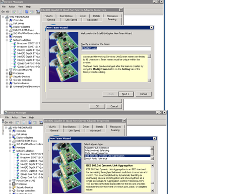

Check if NIC driver on server/PC has NIC teaming/Channel bonding support. This can typically be seen under "Device manager" if its windows server. You can create a NIC team with appropriate ports and enable LACP, then connect it to X670 that has port sharing with LACP configured.
The below image shows what NIC teaming configuration looks like on Windows 2008 server with Intel NICs and Intel ANS drivers.
![9108613163bb498cb118da3734c0af05_RackMultipart20141112-14510-130qe9a-nicteam_inline.png 9108613163bb498cb118da3734c0af05_RackMultipart20141112-14510-130qe9a-nicteam_inline.png](/t5/image/serverpage/image-id/1941i15DCE839E15BE272/image-size/large?v=v2&px=999)
One configured you should be able to see the server/pc ports added to agregator on X670

On the server side you should see new connection under "Network Connections" which is for the NIC team. You can assign IP to this connection and ping between servers.
