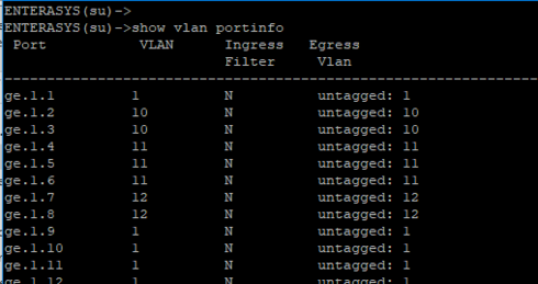

e61920ba861e40ef8b20109ff7cf0ff0_RackMultipart20180305-61666-mai43b-Captura_Enterasys_inline.png
could you please provide the output of "show vlan portinfo port ge.1.x" for both of the ports with the clients connected.
the model is Enterasys B3G124-48
what switch model is it?
