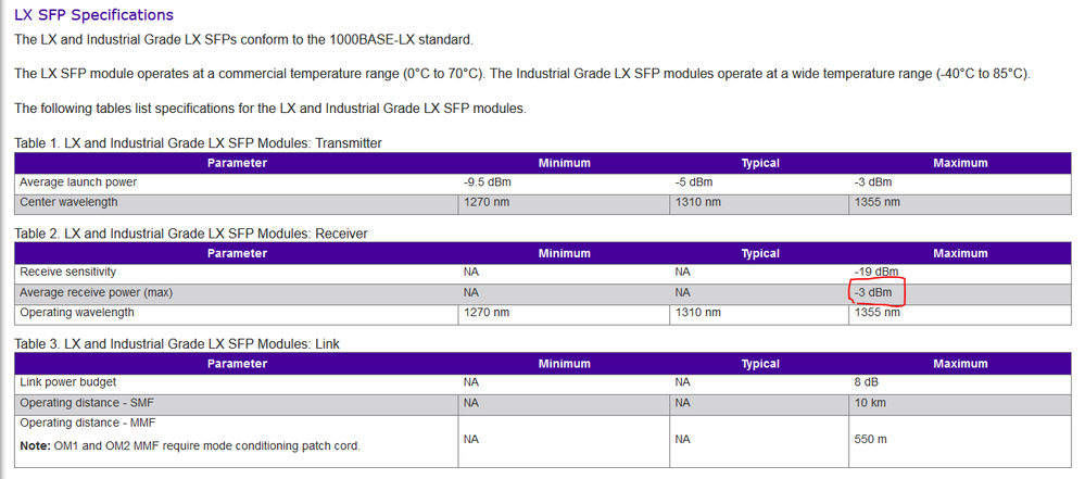

According to 1000BaseLX specs, -3dbm is the max receive power.
https://documentation.extremenetworks.com/pluggable/GUID-36DC6B60-A015-470E-8EB6-3ACE8F4F75F6.shtml
At -1.93dbm you are exceeding that value...

Thank you very much Ludovico!
I’ll control the fiber patch or transceiver both of this device and of the one with which it is connected.
