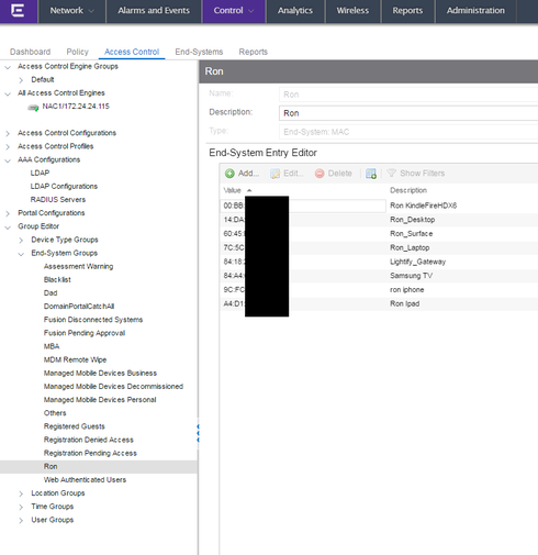

How about a end-system group with the MACs that you'd like to allow.
Then copy the rule that you've used before and link it to that group - move the new rule on top of the other.
13501fa9dbaa4c2083b7bc4600771c4d_RackMultipart20170210-53932-qf4dmz-NAC_endsys_group_inline.png
