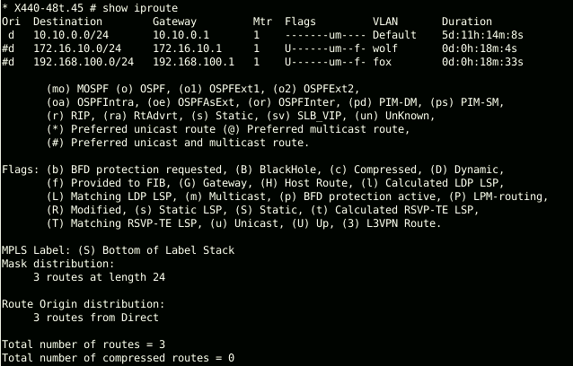

12-15-2020 02:03 AM
well, the routing between the computers I test with the ping command, and the two machines get a ping response from their respective gateways, each machine is on a different vlan, even this part is ok, however, when I will ping one machine on the other does not work. Follow the exit of the "show iproute". Thanks a lot for the help.
12-14-2020 07:45 PM
Hello Grud,
how do you test the routing between the vlans?
With two computer in different vlans and ping?
If yes, what is the adapter config (ip, mask, gateway)?
Can you ping the gateway of the pcs?
Can you provid an "sh ip route" frim the x440?

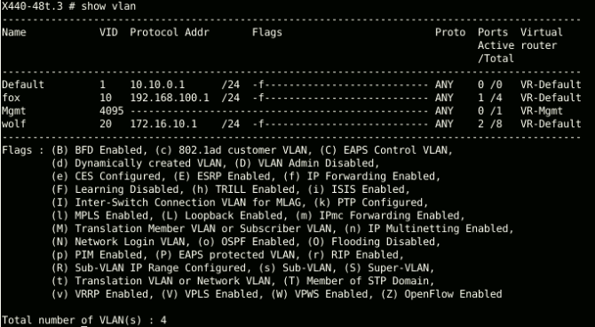

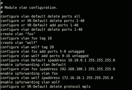

12-14-2020 05:03 PM
Of course! Following is an image with "show vlan" and another with the output of "show config", but only the part of the vlan.
12-14-2020 04:56 PM
Can you provide the output of “show vlan”?
