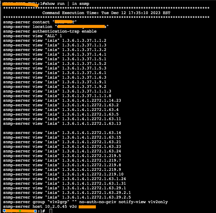

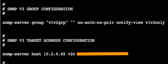

I cant seem to get SNMP working on one our Core Switches.
Model: 7400 Series
Version: 8.4
SNMP works on the second core switch, which is the exact same model,version and on the same subnet
Below is the configuration on the non-working switch:
Am i missing something?

‎12-12-2023 05:59 AM
Hi Tommyt,
Did you check the boot flag "snmp-block" ? #show boot config flags
How are you reaching the VSP mgmt through mgmt vlan interface ? Any difference with the second VSP ? Is the non working VSP host the gw of the Vlan ? Is the SNMP request came from the same subnet ?
Can you share your SNMP request you try ?
Your configuration looks strange, you define a group "v1v2grp" without auth/priv and without read or write view.
Are you using default community (public/private) ?
Regards,
Théo

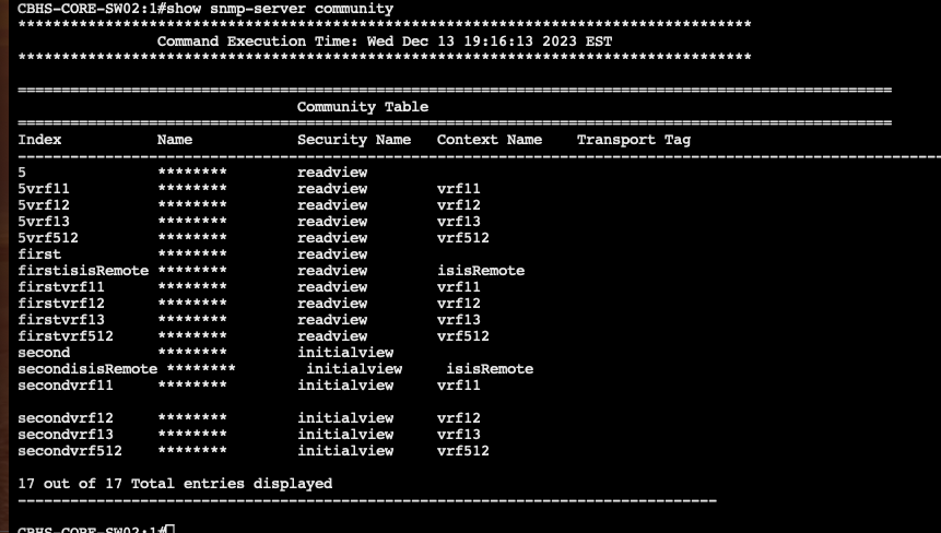

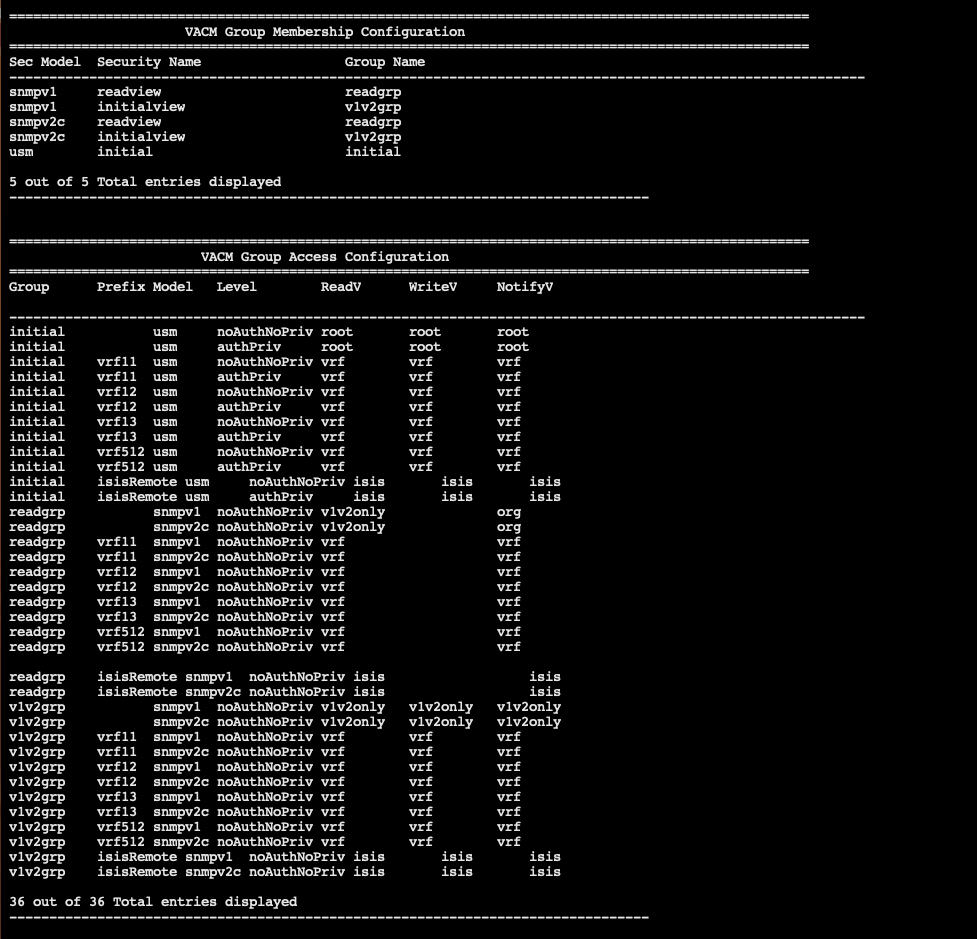

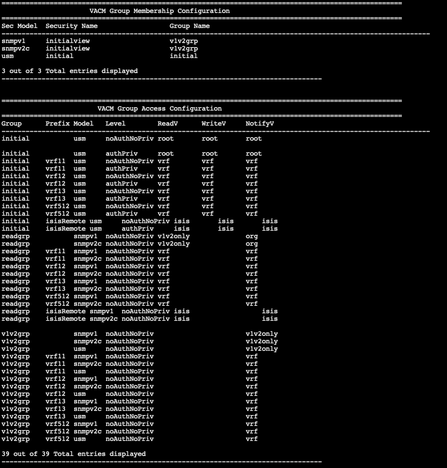

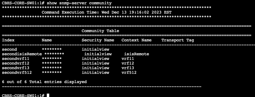

‎12-13-2023 12:27 AM
HI Theo,
I did not configure the working switch, all i did was work on the non-working switch.
In an attempt to get it "the same as the other switch" , i removed whatever community and group that was configured, and then reconfigured the group following this Guide from the Extreme website
Also Attached are outputs of "show snmp-server community" and "show snmp-server group" of both switches
non-working switches "group: output
working switch's "group" output
non-working switch's "community output
working switch's "community" output
