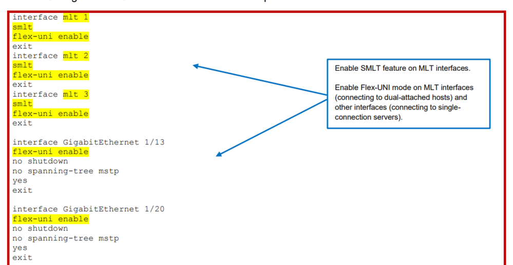

Looking at the EVD, with the exception of LACP, the configuration seems to be valid and you can add Switch UNI ports to an MLT
Looking at this post it seems LACP is supported on flex-uni ports:
Maybe something obvious?

In my opinion you only add the command “flex-uni” to the interface where you want to activate it.
In your case, it is the MLT and not the specific gigabit interface.
If you read the comment from the EVD, it says “Enable Flex-Uni on MLT … and other interfaces...”.
In the EVD, the interfaces 1/13 and 1/20 are not part of any MLT and require specific activation of “flex-uni”. Here what is just before your screenshot:
Just remove the statement “flex-uni enable” from your gigabit interfaces 3/10.
Let me know if it was indeed obvious 7c4228eaffbe4c85b092b45e295bebdb_1f609.png
Mig
Mig
