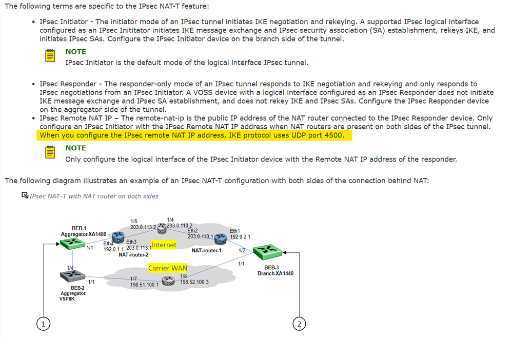

I belive only UDP 4500 is needed:
source "VOSS User Guide (extremenetworks.com)"

This is perfect thank you sir!
