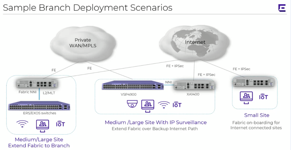

How can I have 2 permanent ISIS adjacencies to the Campus Fabric Connect environment across the two circuits?
Should I not use public IP addresses on the IPSec tunnel endpoints and instead use the same tunnel source address as the VXLAN tunnel but NAT it at the firewalls?
Also, documentation mentions that the XA1400 appliances are hardened - do you know any details on that? What is mean by “hardened” in this context?
I am trying to achieve the scenario on the very left in the following screenshot:
Your thoughts are appreciated,
Thank you!

The ability for the same XA (VSP with FIGW) to connect to multiple providers is currently a bit limited and we are expecting improvements to this in the VOSS 8.3.1.0 release later this year.
However, in your specific case it is already doable as you have one IPsec tunnel and a native VXLAN tunnel. You need to use decoupled mode on the Remote XA IPsec config, using this command which was added to the XA in release 8.2:
8.2.0.0 SW Fabric Extend ability to specify a separate global IPsec tunnel source address (ipsec tunnel-source-address) from the FE IP Tunnel source IP
That will allow your Remote XA to originate all its IPsec traffic via a different IPsec IP source address from the ISIS FE tunnel source IP (ip-tunnel-source-address). You can make this ipsec tunnel-source-address the Brouter port you have facing the Internet Firewall.
And of course, now on your HQ XA you will need to set:
8.2.0.0 SW Fabric Extend ability to specify a logical ISIS interface IPsec tunnel destination (ipsec tunnel-dest-ip) other than the FE tunnel destination IP
...under the logical-isis interface to match that IPsec termination IP which is no longer the ip-tunnel-source-address of that same logical-isis interface.
However note that traffic arriving to the Remote XA, and destined to the new above IPsec tunnel-source-address, once the IPsec encapsulation is removed, there is still an inner VXLAN encapsulation which will still have as destination IP the ISIS FE ip-tunnel-source-address. So it is fine to make this the Brouter port facing the WAN circuit, provided that you use the same VRF for both WAN and Internet circuits (you have no choice anyway, we only support 1 FE enabled VRF), so that the VXLAN tunnel which was IPsec encapsulated can reach it. But if you use a Brouter port, and you lose the link to the WAN router, then both your WAN and Internet circuits will go down which is probably not what you want. You could make the ip-tunnel-source-address a CLIP IP on the XA, but now the snag is that the WAN provider will need an IP route to reach that CLIP. Or else you could make the ip-tunnel-source-address a VLAN IP (supported on XA since 8.1.5.0 and on VOSS VSPs since 8.3.0.0) and then assign that VLAN not only to the WAN port, but also to another bogus port you expect will always be up or at least be up as long as the Internet connection is available (for example the port connecting to your Internet Firewall !). But in this case, note that we don’t support an IP enabled VLAN to be assigned to a Brouter port. So simply make the Internet facing ipsec tunnel-source-address a VLAN IP as well.
Hope you can digest this!

03-22-2021 03:28 PM
Yes, the middle scenario will be the easiest as each box will only have to be configured with a single FE provider (WAN/Internet). You will also get better performance on the VSP FE tunnels without IPsec.
