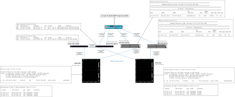

Hoping someone more clever then myself can help me workout why a route on the Palo Alto shown below (10.119.71.0) is add a route via the EXOS devices on the EOS switches as you would expect, but I am not seeing anything via the VSP.
I think its to do with the same routes via the VSP being seen as type 3 LSA’s?
In essence I am migrating the the L3 links on the firewalls from EXOS to the VSP’s. The whole Data Centre is run North of the firewall. So I want to be careful about moving the L3 links across so not to cause any disruption.
I don’t think there is anything necessarily wrong, as the VSP learned routes will I believe kick in when fully migrated across, but what to fully understand what I am seeing to be sure it is safe.

05-27-2021 11:11 AM
Here you go….
Basically what you are seeing is the adjacency on VSP-Core1 & 2 back to the Palo Alto.
VSP-Core1 has an adjacency back to the EOS switch (172.20.250.217 - 2.2.2.2)
Noticed an error in my diagram. There is actually x4 VSP8400’s in this topology, but only added two to the diagram with one of the links to the EOS switches being incorrectly placed, but effectively it will be the same thing.
The other adjacencies are basically a /29 subnet (VLAN 3401) to all the x4 VSP’s mentioned..
One thing to note is that all the subnets north of the Palo are in area 0.0.0.255, but all the connections to all the switches are in area 0.0.0.0
