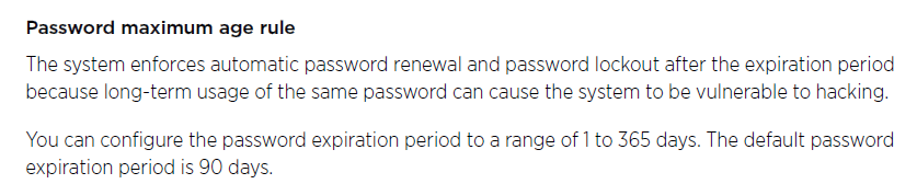

See the below snippet from the VOSS User guide:
The command to set the aging time is “password access-level rwa aging-time <1-365>
This is for the local device management password.
