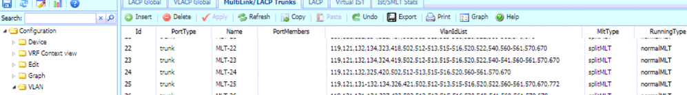

The part that is confusing me is the VLAN assignment against the MLT, here is an example of this when using SMLT in the EDM:
And similar output from a ‘show mlt’

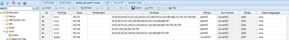

Take this example of MLT 64 below. This was originally a SMLT interface but since converting to a normalMLT it has stripped off the VLAN associations that where present previously against the MLT , and changed the portype to access?:
Then when I bring the interface up it changes the port type back to trunk and adds the VLANs to list:

I originally configured the MLT 25 as a SMLT, when looking at the outputs it shows all the VLANs associated as you have listed above, and in the EDM interface example below:
If you take MLT-64 as in the example above, and I do the same for MLT 25 and I convert it to a normalMLT.
At that point the VLANs that where associated to the MLT have gone, as can be seen in the image below against MLT-64. I believe at this point it is using the VLANs against the port number.
When I then convert that normalMLT back to an SMLT those VLANs are no longer showing against the MLT?
