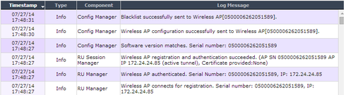

The normal logs for a AP that connect to the controller will look like that...
I think in your case that last one "Blacklist successfully sent..." is missing.
In that case it's a MTU problem = the AP can't discover the MTU on the VPN link.
Just set it in the static AP config to MTU=1300 - if the VPN uses a smaller value try it with a even smaller MTU.
