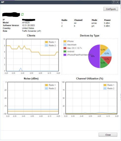

I'm looking at a DCS event within netsight that lasted ~5 minutes.:
ad8d7e3b18934b08a17722205036b68c_RackMultipart20170928-114059-thhvq5-WirelessEvents_inline.png
But when i look at the AP on the controller, the graphs do not show and spikes in Noise level:
These contradict each other, so i'm wondering if anyone can tell me how often EWC polls for that graphical data and weather it's possible that events 5 minutes and shorter are not being represented. Thanks much.

Thanks Bin. Is it possible to modify the polling time for EWC rather than EMC? I rather reduce the polling time on EWC to 5 minutes than increase the polling time on EMC to 10 minutes.
Jacob__Praveen
The Netsight and EWC polling intervals are different. That's why you see contradictory results on the AP reports.
Nathiya_M
Hi Joshua,

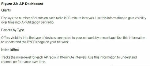

EWC polls graphical data every 10-minute interval.
Snipped from User guide.
