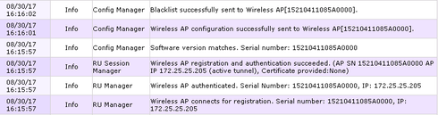

Enable all log messages on the controlller
GUI > Controller > Logs > Logs Configuration > System Log Level > Information
Reboot the AP and you should see the following messages in the controller log for the AP registration ...
2c39f3e7f4da4316affaa6fad9a4824f_RackMultipart20170830-13530-1nsmqyv-EWC_AP_registration_inline.png
If the last message (the one on the top = blacklist......) is missing the AP isn't fully connected to the controller.
-Ron
