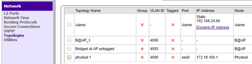

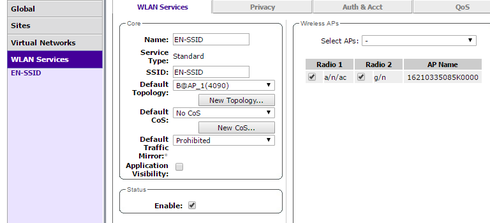

Have a simple configuration with internal DHCP.
1 client Sansung Galaxy receive IP 0.0.0.0.
Change radios as here - {previously referenced article has been archived}

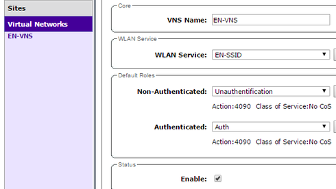

In both rules Containment VLAN 4090.

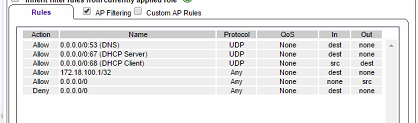

Auth rules empty (alow all)
Nonauth rule below

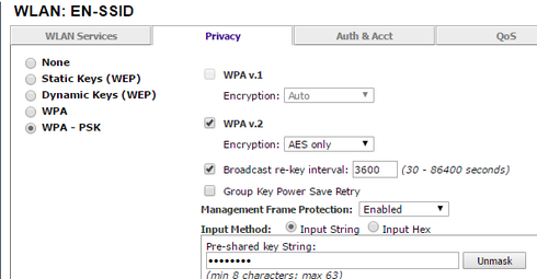

From my experience they don't "see" the change > they get kicked from the WLAN but connect in the same second again > there is no AP reboot or any other longer outage.
Doug
For Reference: https://gtacknowledge.extremenetworks.com/articles/Solution/Certain-devices-not-connecting-to-WPA2-P...

I have the similar problem when some clients (IOS / Android) try to connect to a WLAN with VNS topology "B@EWC" sometimes reporting "Incorrect Password" if I restart the AP, the issues fixed but eventualy the problem appear again.
I read in a few Extreme´s reference articles that solucion for that problem is disable "management frame protection" but my doubt is what will happen with the clients connected in that moment when I do the change in the wlan service ? they will be disconect ?
