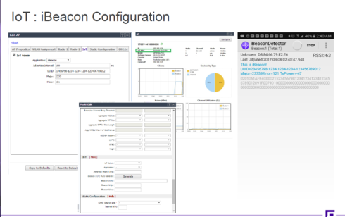

Hello Ron
From the 10.31 Knowledge transfer
33bf22380331485c8a739180dd0ceae5_RackMultipart20170419-70755-1o55q76-iBeacon1_inline.png

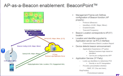

33bf22380331485c8a739180dd0ceae5_RackMultipart20170419-83125-pu4uwe-iBeacon2_inline.png

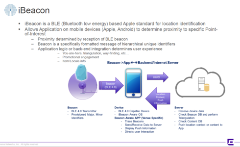

33bf22380331485c8a739180dd0ceae5_RackMultipart20170419-1120-1y0jcaq-iBeacon3_inline.png

You'll generally need a third-party service to manage the integration, eg https://locatify.com/blog/indoor-positioning-systems-ble-beacons/ (first google result for [ble location]).
At a tech level, you'd need to write an app (or use a framework) that listens for the beacons and when it hears one of yours (they broadcast a (programmable?)128bit code) the app looks up the code in a database with the beacon locations to find out where you are.
https://en.wikipedia.org/wiki/IBeacon
https://developer.mbed.org/blog/entry/BLE-Beacons-URIBeacon-AltBeacons-iBeacon/
