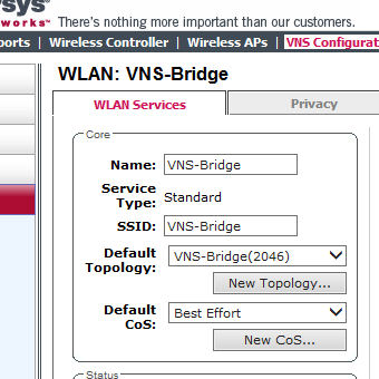

Check if you have selected the correct topology for your VNS (under WLAN Services).
002f0baf19a54bdaae58ff840c3979f2_RackMultipart20151015-11641-15tunth-Unbenannt_inline.png
If no topology is selected as default topology, the WLAN Client's packets are visible at the switch port, because the then used default is B@AP, untagged.
