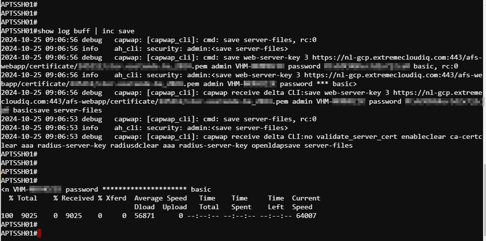

‎10-28-2024 12:47 AM
Hi Christophe,
This is the output:
Pushing the key is not what I expected to see in the output. The change I made was on an SSID (change of RADIUS server) and I'm not seeing that in the log. I will look into opening a GTAC ticket now.
‎10-25-2024 05:48 AM - edited ‎10-25-2024 06:14 AM
Hello @Bart_C,
Did you run this command in CLI?
I see from output that you are trying to push the web-server-key .pem file but see no errors listed when you ran the save command in CLI.
If you are still experiencing issue, your next step is to open a GTAC ticket.
Hi Christophe,
This is the output:

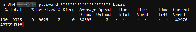

‎10-25-2024 12:24 AM
Hello Christophe,
Since my posts with code were getting deleted, I took a screenshot with the output.
