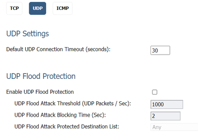

Have you also tried increasing the UDP Session Timeout for UDP port 12222 to 300 seconds. (Firewall Settings > Flood Protection > UDP) in the SonicWall firewall configuration for XIQ CAPWAP?

I just looked, and we dont have anything specific to port 12222, just general settings:
if I change that, do you think multiplying it by 100 would be too large and actually cause us issues? and i should just do it by 50 first, so 150 seconds to start and see what happens?
although i am concerned that no matter what number you put in the box, you get this warning:
that makes me quite nervous.. remember all i did was update firmware on existing AP's.... i didnt change anything on the firewall to cause this......
