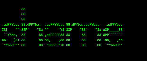

Yaep, cli works, i’m developing some ASCI code to show customer floor plans and topologies…
