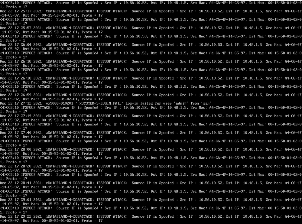

Hi guys,
Thanks for your answers, really apreciate it.
I tried to ping the AP from the VX9000 and I have the message "connect: Network is unreachable". What can be the issue? The subnets see each other, from my laptop or other server I can ping from one subnet to the other w/o any issue. Any advice ?
