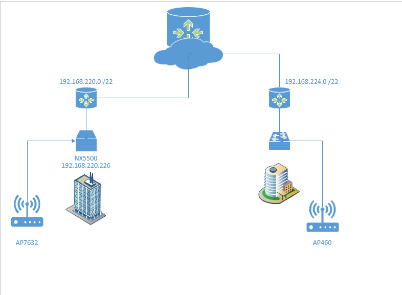

So for question number 2 let me make a crude drawing and fake IP addresses to kind of show what I’m trying to do.
So I have two buildings both with WiNG access points that can be adopted by the NX5500. The buildings networks are connected together and can access devices between them but they’re on their own subnet.
The building with the NX5500 can see the access points at that location and adopt them. However because the second building is on it’s own broadcast domain I don’t think I’ll be able to have the NX5500 adopt building 2’s access points unless I configure a setting on each access point with layer 3 adoption or telling it the IP address of the NX5500.
Is this the only way to achieve adoption for this scenario?
