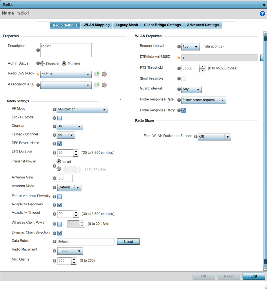

Can someone please kindly help?
I couldn’t find 802.11AX option on the radio config page. Does anyone know how to turn it on? I added LDPC to radio profile through CLI command following this tutorial: Q A: How to enable or disable 802.11ax on WiNG 7 | Extreme Portal (force.com)
My AP is running 7.1.1.0-034R firmware.

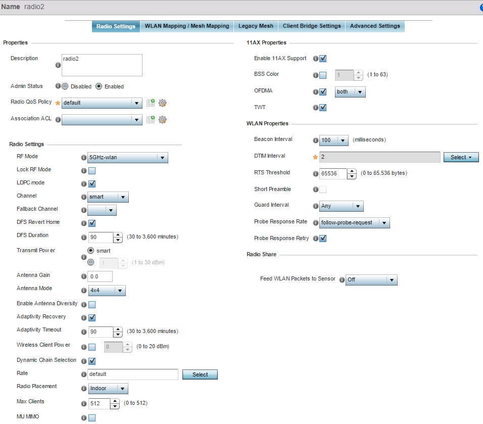

Looks like it’s not available on your version of code in the UI. Here’s the screenshot from an AP510 on 7.6.3.1:
Have you tried CLI commands:
en#config t#profile ap510 <profile-name> (default profile name is: default-ap510)#interface radio 2#no 11axSupport#com wr#show context (for verification) interface radio2 no 11axSupport
We would also recommend you upgrade to a more recent version of code.

08-23-2021 05:09 PM
Check here
I think you need to be on WiNG-7.1.2 or higher to see those new options in the UI.
