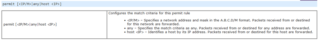

rfs01(config)*#ip snmp-access-list cti
rfs01(config-ip-snmp-acl-cti)*#permit any
% Error: Invalid IPv4/mask format
rfs01(config-ip-snmp-acl-cti)*#permit ?
  A.B.C.D/M  Source IP address range to match
  any        Any source IP address
  host       Single host address
rfs01(config-ip-snmp-acl-cti)*#permit any ?
  <cr>

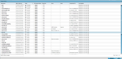

IP 172.19.0.97 belongs to AP 7532 and is part of the vlan that the APs get IP from. Should the IP itself be on the allowed list?
all 7532 in the image below.
