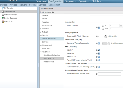

Since they are both VC, change the Area Identifier id. This should keep all APs only seeing APs from its own VC.
‎06-21-2017 06:00 PM
You can try disabling Mint Link setting Or change the Area Identifier id. This should prevent APs from seeing each other via mint.
