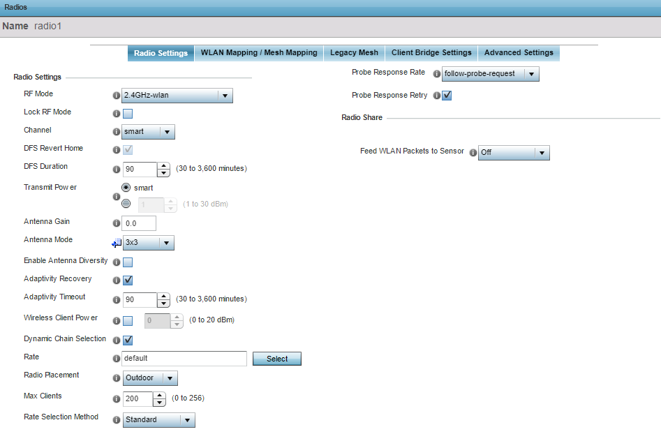

This is my configuration. How do I configure it correctly? I will use 1 anten Omni and 2 anten sector for band 2.4Ghz.

Have you configured the AP radio setting's Antenna Mode for 1x1 operation or enabled the Dynamic Chain selection options in the AP's radio interfaces?
Do you have more than one antenna you can connect at a time to test?
Where are you reading those signal levels?
