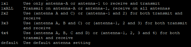

Ideally all connectors should be used, but you have other options as well. To determine this, SSH into the AP and run the following commands:
#self
#int radio 2
#antenna-mode ?
You'll see the following:
