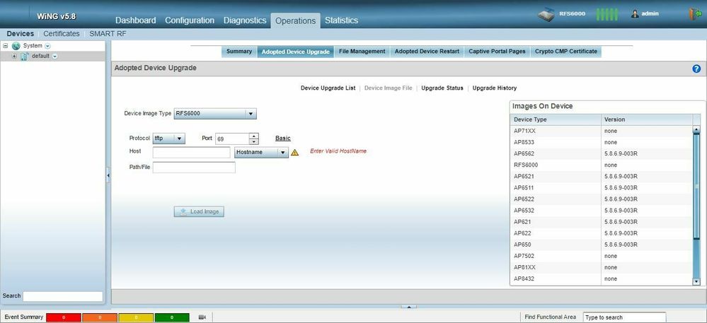

Hello ,
How to delete AP firmware(image file) form Wireless controller ?
Thank you for your advice .

Aroon,
This is intended for images that has been loaded on the controller by yourself. If the controller has no-lean image, you will not be able to remove those images included on the controller firmware.

Also Aroon, you cannot delete any image files that come *built-into* the controller.
As Daniel said, you can only delete AP images that YOU had previously manually loaded onto the controller. The others that came with the controller are NON-removable.

Hellp Daniel , this is result
rfs6000-6EA830#dir flash:/upgrade
Directory of flash:/upgrade
-rw- 19244503 Thu Aug 9 17:19:35 2018 mcn.img
I wanna delete AP7502 firmware only .butt there are only a file.
Thanks ?
Daniel_Fraile_V
Hello Aroon,
Here you can find an article describing how to do it:
https://gtacknowledge.extremenetworks.com/articles/How_To/How-to-remove-AP-firmware-images-from-the-controller-once-not-needed-anymore
