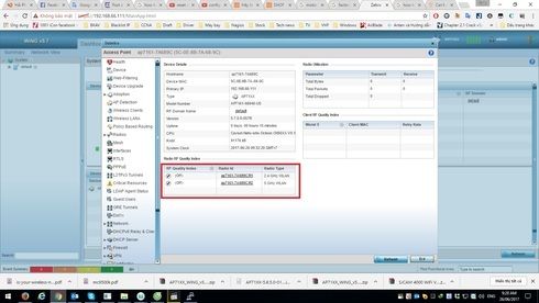

Hi everybody
My radio is off, how to turn it on.
Thank you!

If you look on the first screenshot you'd see that it's a US model.
I'm not a WiNG expert but I'd assume that a US model only supports country US.... at least that would make sense 🙂

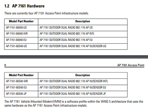

I've found that list in the install guide online...
95e31fedc1fd4dec885aec9832811e2c_RackMultipart20170626-130287-1sghg5q-wing_ap7161_model_inline.png
Tuan,
The country code specifies what channel and power levels are allowed to be configured on the radios. Using the wrong country code in your country may be illegal. Check with your local regulatory authorities first.
As a general rule, -US product code are to used and sold solely in the USA.

True is my product code is US, can it work reliably with systems use Ap-7161-WR
